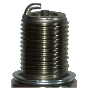

I have GN-1's I'm going to try the champs.
RL
You should look at the plug I'm using for GN1s. Some fast people have used them with these heads.
Autolite Racing AR 3934. This is what they look like out of the box.
That looks like a very good plug to try. I wonder how fat the ground electrode is compared to the Champs.
The shorter or fatter the ground electrode, the easier it can transfer heat to the thread section and then to the heads. You want to look for short AND fat, if it's possible to find both in one plug design.
Remember, I stated that the ground strap on the Champ is so short, I can barely get the gap to close down to my gap spec of .022". Can't get much shorter than that. The shorter, the better.
