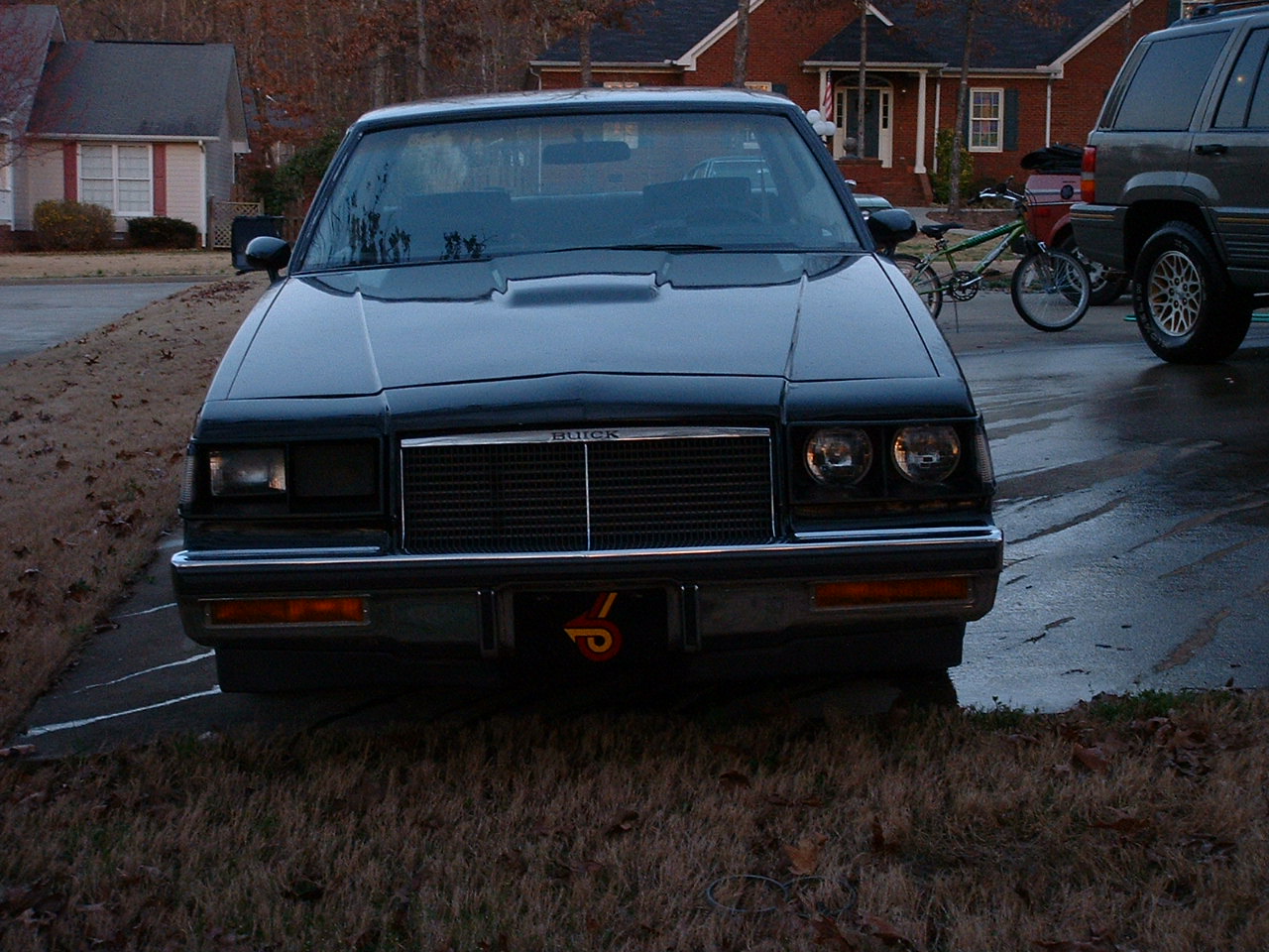

5 bucks from a junkyard and this is what you get, but i dont know if i like it or not, its different though
www.insanelyquick.20fr.com/roundlights.jpg
www.insanelyquick.20fr.com/roundlight.jpg
