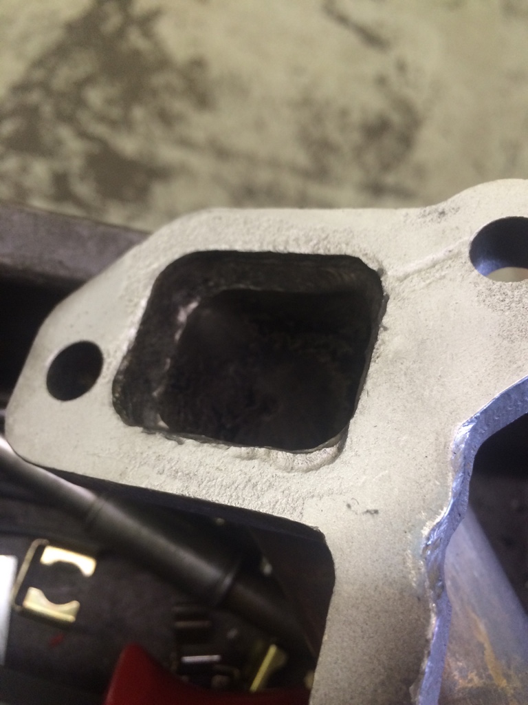

ya, but OEM is stainless to cast iron. Im just talking about aluminum to mild steel (TA race header flange). DO you think I can mate those surfaces up and be trouble free?

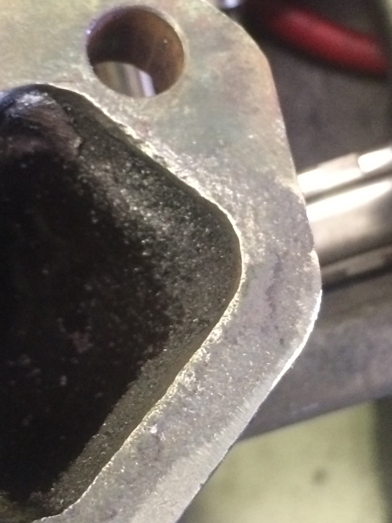

Mild steel flanges. Less than 1 year of run time:
Geez .. I dont think ive seen a cheaper chinese flange .. Why bother even building a header if using something like that.. Thats not a flange thats a joke
I'd be ruffling feathers all over the internet if I posted the full picture. Many people have paid $1000+ for the same headers with the same flanges.
Are you saying bison that the primaries are stainless and the flanges are mild steel on the gn1 se headers ? Thanks
Better question is why were they even bolted on?
