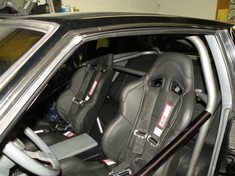

You do unbelievably CLEAN work. How did those seats fit? Did you have to fab some brackets?
Thanks...Seats fit nice between the down bars and center console. They recline back against the seat supports on the roll bar well.
I purchased the seat brackets from Corbeau also, they mount using the factory floor bolts. They fit great, I had to open the holes up a little on the brackets to mount to the factory bolts. The brackets have sliders and are double locking...
