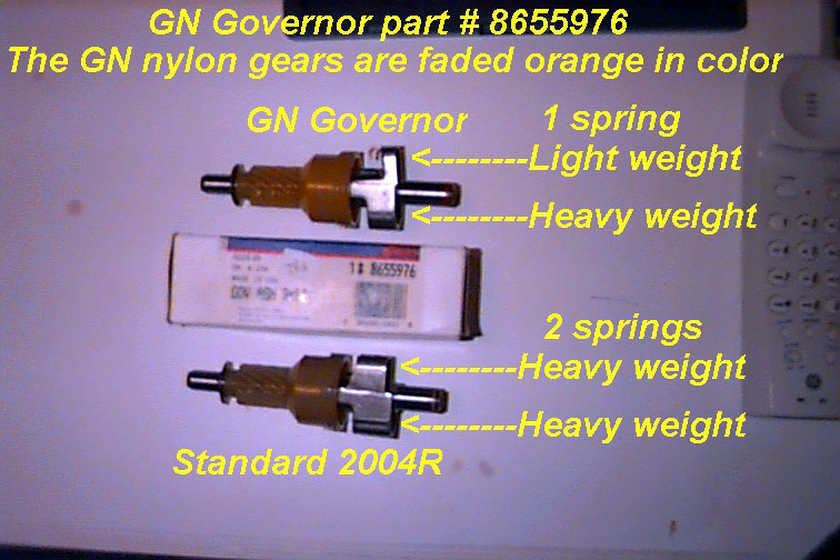

Unfortunately, the only real way to tell what you have is to pull the pan and take a look. These things are so old these days that the ID tag could mislead. The governor is very specific and it's located toward the rear of the trans under the four-bolt cover.

Could I ask you to take a quick look at these pics as I took pan off tonight. The governor seems correct as you pictured above as does the BR3 valve body, but take a look at the wiring pic. There are two coming out of the solenoid but I see only 3 wires total and want to make sure it's correct before I sell it.
2/3rds of the info you posted look like it's a GN 2004R and if wiring is correct then I think I am good to go.
That is definitely a gn governor and valve body. The wiring issue: see that brass plug in the back of the valve body? That's where the third gear pressure switch used to be and someone plugged it and deleted the wire to it. Easy enough to change but I don't know why they'd do it to begin with. Someone's been in it but it's still a performance core. Servo on the side should have the last three digits in the casting be "694" also. Vb and governor are the big things though
