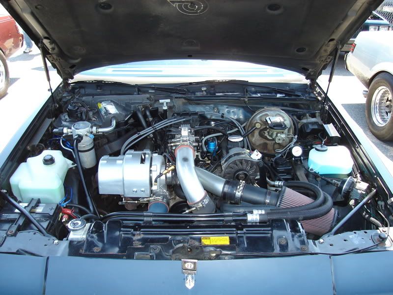

My old Blue T's quick run down, Stock 94k mile motor with valve springs, dr timing chain and an RJC power plate, RJC bleeder valve, TE-60R (same turbo you have, but with a dual ball bearing chra) adjustable fp regulator, Kirban plug wires, Autolite 23 plugs, hot wired Walbro 255lph intank pump, 60# Mototron injectors, Turbo Tweak chip, PTE stock location IC, 3" MAF pipe, stock MAF with K&N cone filter, 3" THDP, dual 2.5" cat back with Welded Ultraflow mufflers, Pat's 10" 3000 converter, stock rear upper and lower control arms, dual air bags, stock posi rear end, large rear sway bar, Mickey Thompson ET Street 27x10.5-15 tires on stock T wheels. 3670# with driver.

My tune was simple, fuel pressure set vacuum hose off at 45psi, pure C-16 race gas, 26* timing in all 3 gears and 26psi of boost. Plugs gapped at a tight .032. On my best run, O2s were .750's with zero KR. 78* ambient temp. Best pass: 11.72 @ 115 with a 1.65 sixty foot, launching with 12psi.
This was back in 2007 at the GS Nats. Very simple combo, on a stock motor.
So, by looking at your setup, you have mph to be gained with higher boost levels, upping the timing and either finding the sweet spot for alky/pump vs timing, or going with straight race gas and high timing. And you definitely need to address the shift points too. 30psi is about the limit for a TE-60 turbo, even though some have run it higher than 30. It has pushed full weight Buicks into the 119-121 range at those boost levels on combos similar to yours.
