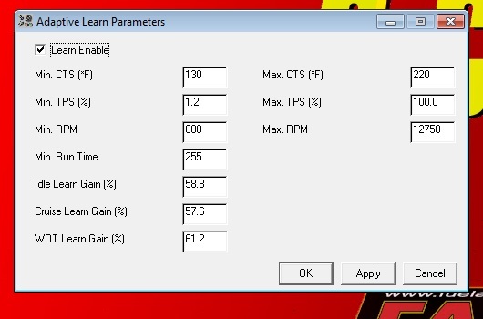

Here is a screenshot of parameters
Adaptive Learning adjusts the Volumetric Efficiency vs RPM and MAP table for minimal wide band O2 sensor correction needed, using the Target Air/Fuel Ratio versus RPM and MAP table as the basis, in the cells that are touched while driving.
Thanks, that helps explain it. This is similar to the stock computer with BLMS thats one thing that I really liked with the stock set up, because when you cruise the numbers always change depending on engine temp, air temp, etc.
