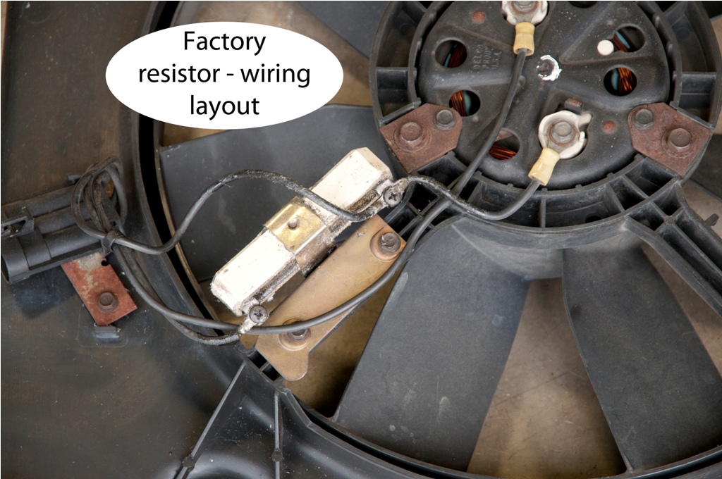

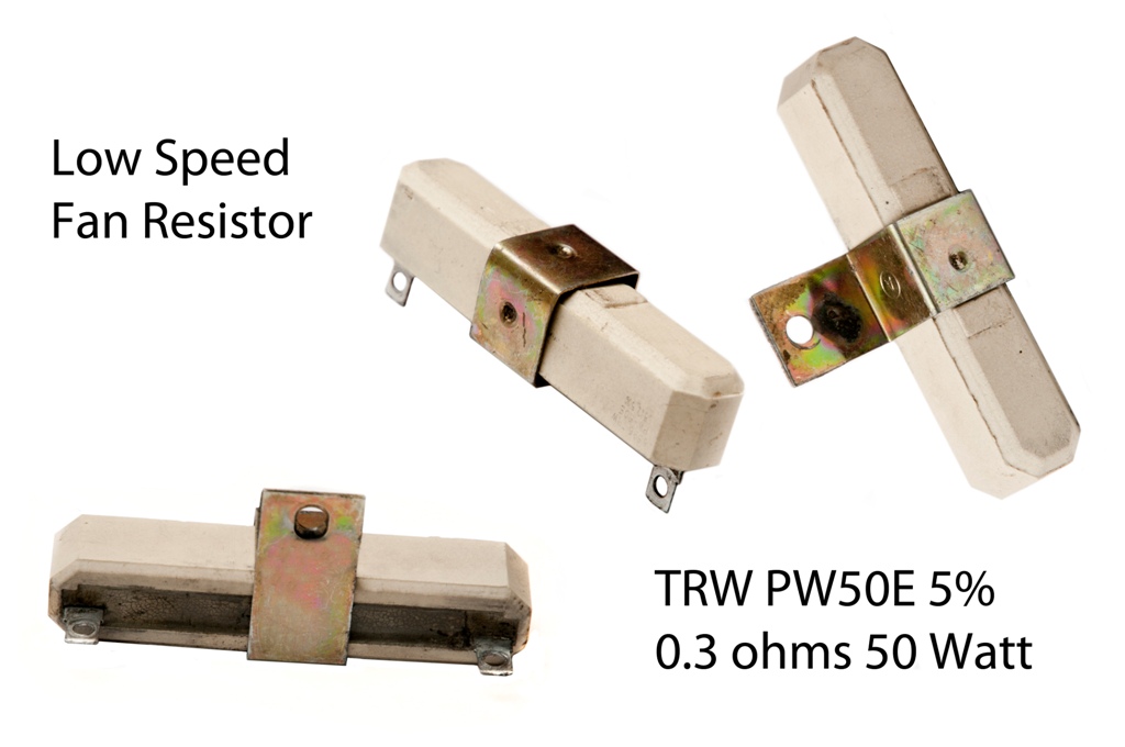

autozone part number cr107 oreillys is ru12

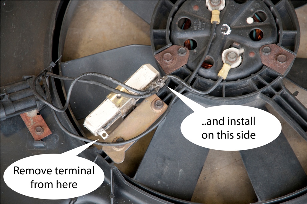

Will still be needing and looking for an oem replacement tho.got one @AZ (in stock) installed it and all is good:>). Thank you very much, for providing this very cost effective option!!
