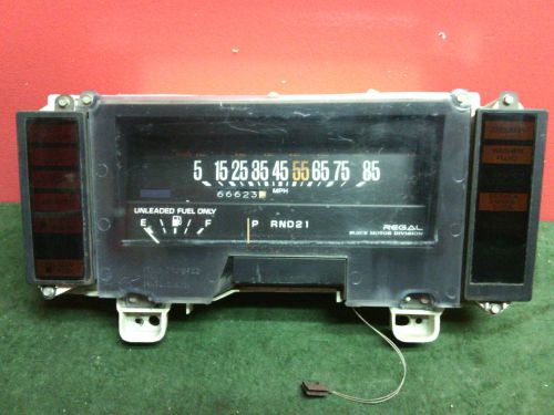

GN's only had 3 factory dash options. The GNX has your round needle dial type, digital - blue display( which you can not swap without changing the fuel sender, as far as I know) and your more common with the needle that sweeps across the panel past the useless 85mph on the right hand side that has the boost and rpm gauge in the lower right corner. If yours doesnt have that boost/rpm in the corner it probably has been swapped with a regular Regal. I would question the mileage on the car then. My astro roof car has the digital gauge set up in it. I think that all of the astro roof cars that I have ever seen had the digital dash in it. I have been wrong before tho. Hey take a pic and post it.
Thank you for the reply! I can take a picture when I get home, but it looks just like the second picture you posted, yet without the tach and boost readout. I figured it had been swapped but unsure of the reason why, as the mileage even on this cluster is high at 140,000 and doesn’t function properly.

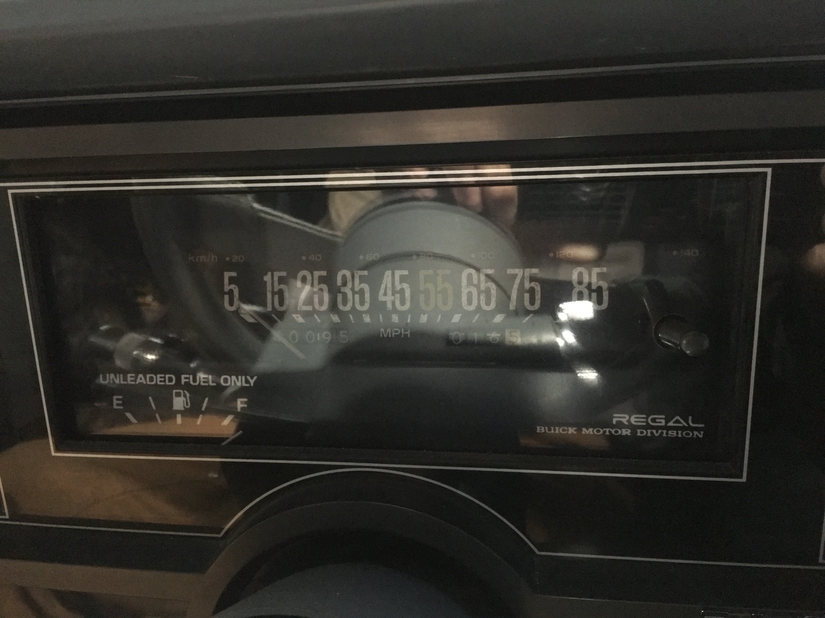

I was of course wrong about the mileage on the cluster, I forgot it doesn’t read six digits and I only assumed it had rolled over. As you can see, it has the regal text where the readouts are on other clusters.
Yea that’s just a stock regal gauge cluster . All the t types and Grand national came with the Boost gauge and rpm tach at least that’s my understanding .
