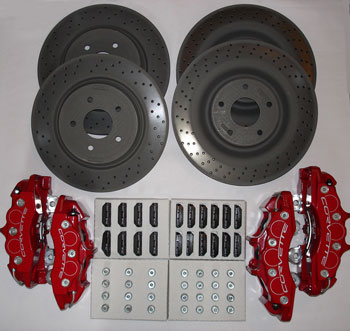

Zo6 are on the front turbo regal and i install WS6 trans am rear disc brake. everything works, even the e-brake. e-brake cable is from the 96 chevy impalla SS with the LT1 engine.
another modfifcation i did what with the hydroboost/master cylinder of the 97 s-10 blazer. I had to shorten the padle shaft 1/2 so it will work with the TR.
Notice the firewall mounting plate if from the powermaster unit. all you need is the powermaster mounting plate so the hydroboost can be bolted to the firewall.
COMPLETE project cost me about $800.00 front and rear brake part (new). and the labor is given...
hope this help buddy. peace.

THANK YOU, now i can upgrade to some drill/slotted rotors. awsome web-site.
i will look into it some more.
i like this set-up . i wonder if they will do the buick logo or leave the caliper blank (no-name)
oh, my complete OEM set (front/rear), new parts cost be around $800.00 so this will be in most member budget.
