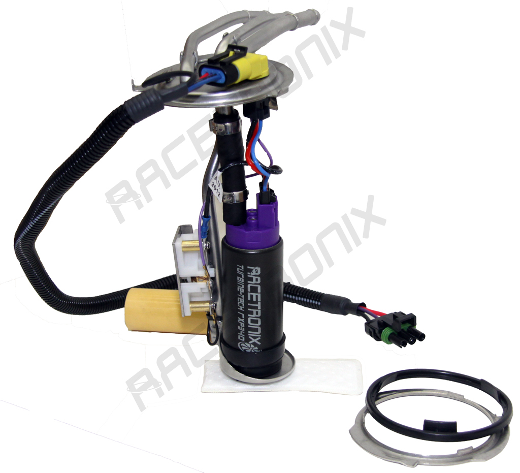

You may want to consider this item:
http://www.racetronix.biz/itemdesc.asp?ic=FPS-G7RXP340M&eq=&Tp=
It comes complete with a pre-installed 340LPH pump and the sender is properly wired to support the current demands of the pump. A stock sender is NOT!
The sender is stainless and the lines are non-tapered for maximum flow. This must be used with OUR 10 gauge hotwire harness for maximum performance.
If you require more fuel but want to use stock lines you may consider our twin 255LPH system listed in our sig. below.

This is the one I ordered. Should receive it and the hotwire kit tomorrow
