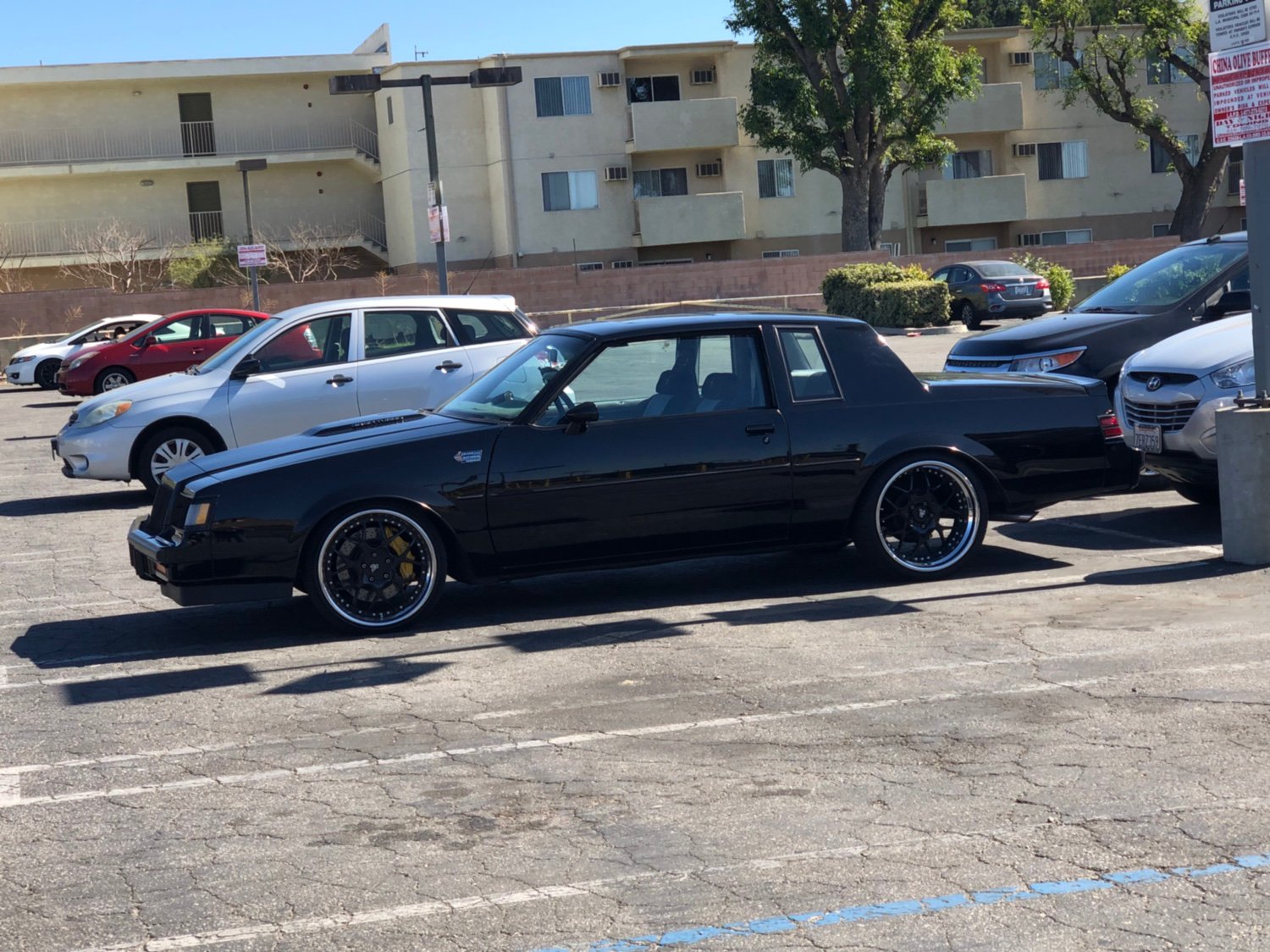

Drop spindles plus springs will do that in the front but not the rear. Coil overs or a kit like Ridetech would be the best bet. Eibach springs alone won't give the drop your looking for. They lowered my car about 3/4in in front and 1in in rear after a couple hundred miles.
