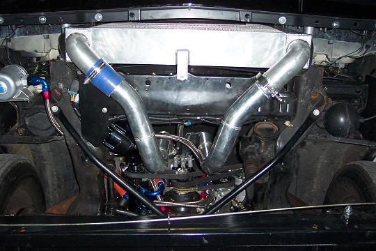

I wouldn't mind seeing some pictures of your 4276 piping when you get it finished. ( compressor inlet and outlet ) Looks like I will have to do some fabrication to accomodate the flange type connection. Looks real tight fitting under the throttle body also.

Some pics of the exhaust and intercooler piping done.
This the complete pics:
jwracing-fab.com :: View topic - Billy T's 1987 Grand National Intercooler / Exhaust Tubing

Billy, that looks like a burns stainless muffler ??? what size exhaust is that ? It's coming along nicely !
Billy,
That looks really nice, what is the rear cross over for?
Nope, Burns stuff is way over rated and $$$$. That's a cheap mild steel Dynomax bullet muffler that I bought from Summit. Exhaust size is 4". I didn't opted for stainless because my car is parked in a heated garage and doesn't see inclement weather use. I'm thinking of sending the exhaust off the Jet Hot to be coated.

Billy,
Thanks.
I have a fobia that I might buckle the quaterpanels since the frame rails are notched. By notching the frame, the lower control arm frame mounts want to twist up into the floorboard. I re-plated the frame with 1/8-3/16 steel plate. I also have the HR lower control arm boxing brackets. I'm thinking about tying the lower mounts into the crossmember. And I got tired of it laying around in my garage.:) So I braced the sh!t out of the car.

Cool ! What's the orange wrap around the trans lines in the last pic ? Thermal proteccion ? Billy do u have a pic of ur cowl dip tray available ? I'm about to install mine & any pics of it installed would be useful along with any advice or pointers. Thanx.
