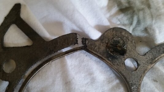

Mine was barely cracked at the top of #1, no milkshakes or coolant leaks, and the timing chain was already done, no cleaning of inside the motor necessary etc. Outside up top parts took about a day to clean all the parts though.
Only did one side for about $300 in parts and tools I needed (head bolt tap was $15).
