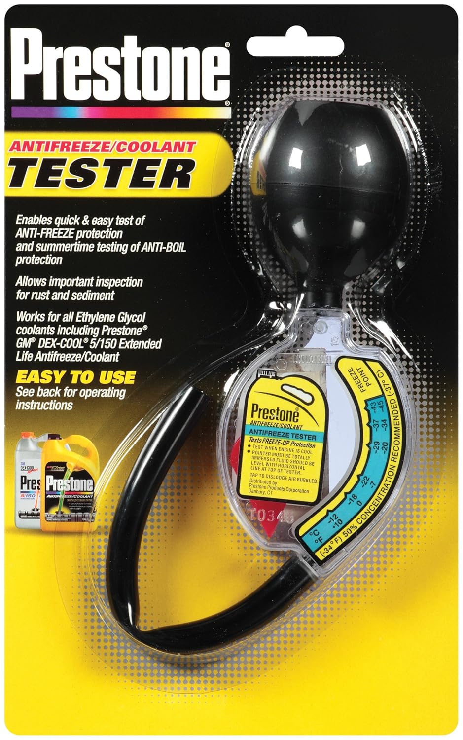

and get an antifreeze tester- they are cheap.. i have a Prestone one that i got at Wal Mart about a decade ago for a few bucks.

Al your best bet is to test it with a tester like what Derrick posted up.

If I am not mistaken, the hydrometers are temperature sensitive, that is, specific gravity changes with temperature.
Check the directions.
This is the one I use
I just drained another 2 gal. And finally got it to -44*
