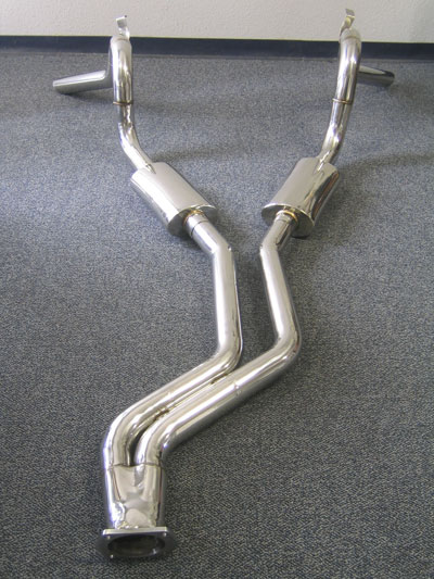

as for 3 inch exhaust systems try Gbody....the pypes is the go to one for stock format replacement and most popular. By stock format I mean way it exists its not a single cross flow muffler set up its duals...owner of Pypes is a long time good friend of mine and company is located only about 20 mins from my shop.

http://buickgn.com/CatBack.htm

Kirban's is the way to go. Dennis is great to deal with. His customer service is outstanding and if there's any issues he will resolve them immediately. As for the 3" exhaust, I bought mine from TR Custom Parts. If you purchase it from them by the package with the ss clamps. The optional ss band clamps are nice. Haven't installed mine yet, but it's nice craftsmanship.
TR CUSTOM PARTS has a great cat back system and the mufflers are the GNX type. Its like jewelry and sounds great. Nice to see that Kirbans GNX dash fits well and installs easy. Just put out there that WOM had options. Always good to know where you can get parts from the most vendors.
