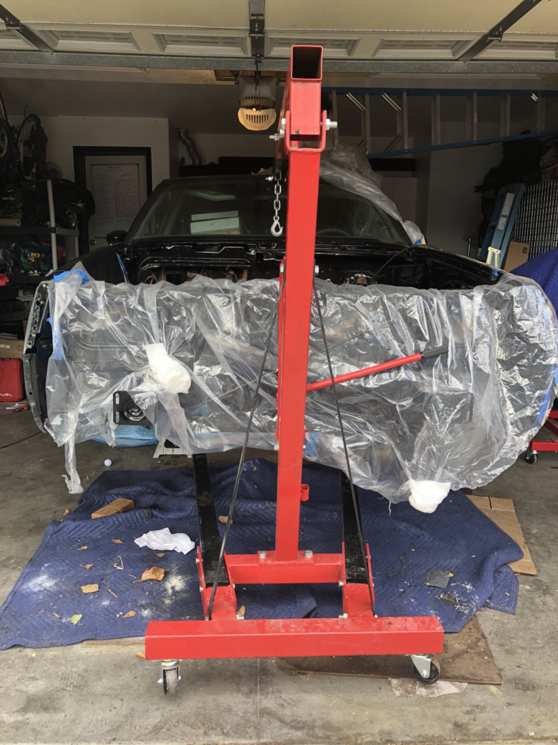

I have an 87 T-top GN what are the best lift points to remove the body off of the frame and other than the steering linkage and body mount bolts are there any other fasteners or parts holding the body to the frame? I should mention that I have a 10 ton over head bridge crane to do the lifting with.
I used an engine host.. remember to remove the e-brake line.
I have the ability to lift it completely overhead. Is there a safe way to do this without damaging the body?
I hooked it through the bottom where the notches for the bushings are. I couldn’t find a way to hook the rear where I thought it be safe.
For the rear I jacked it up where the gas tank goes. Let me know if you find a safe way to lift at the rear.
