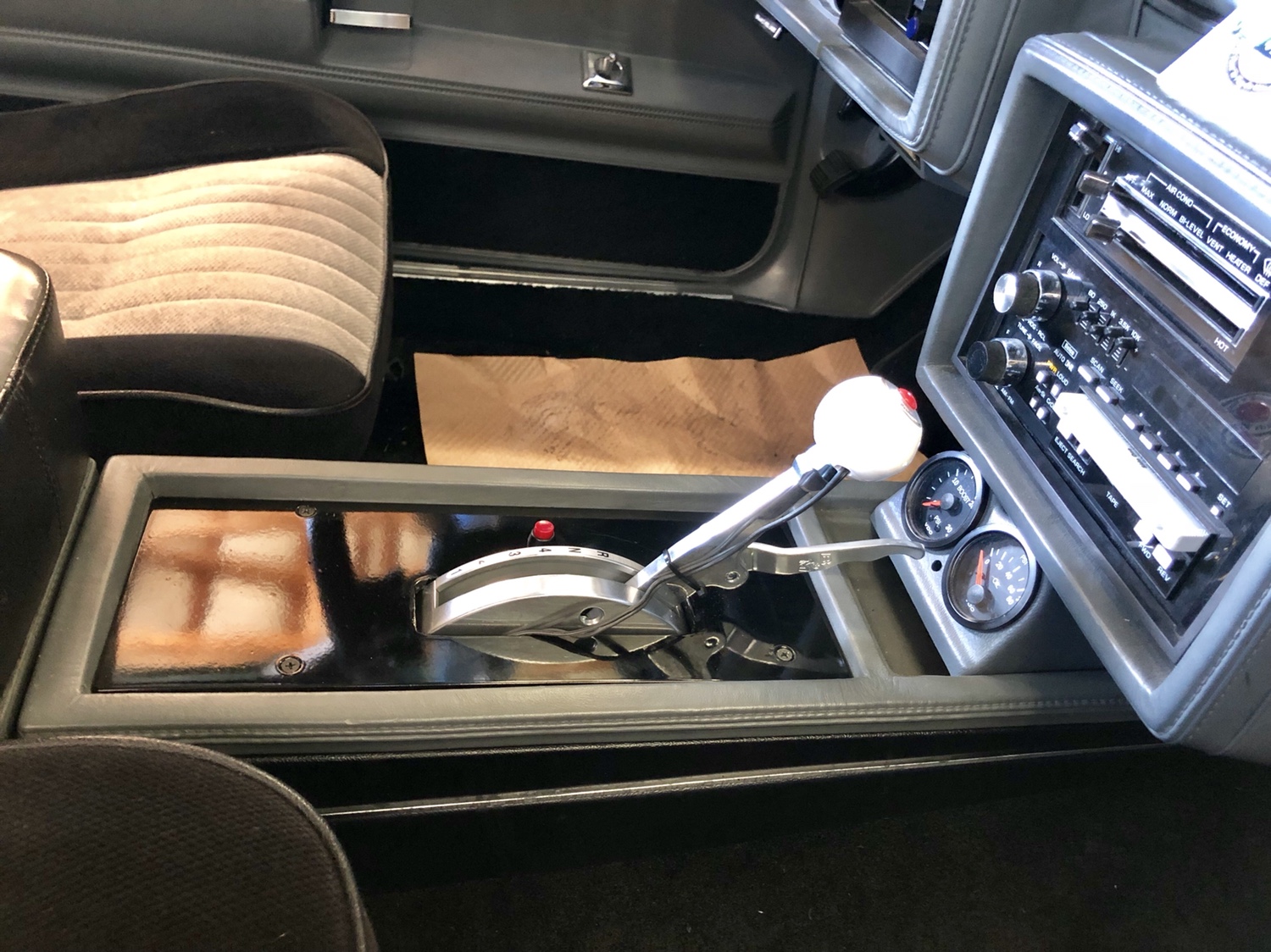

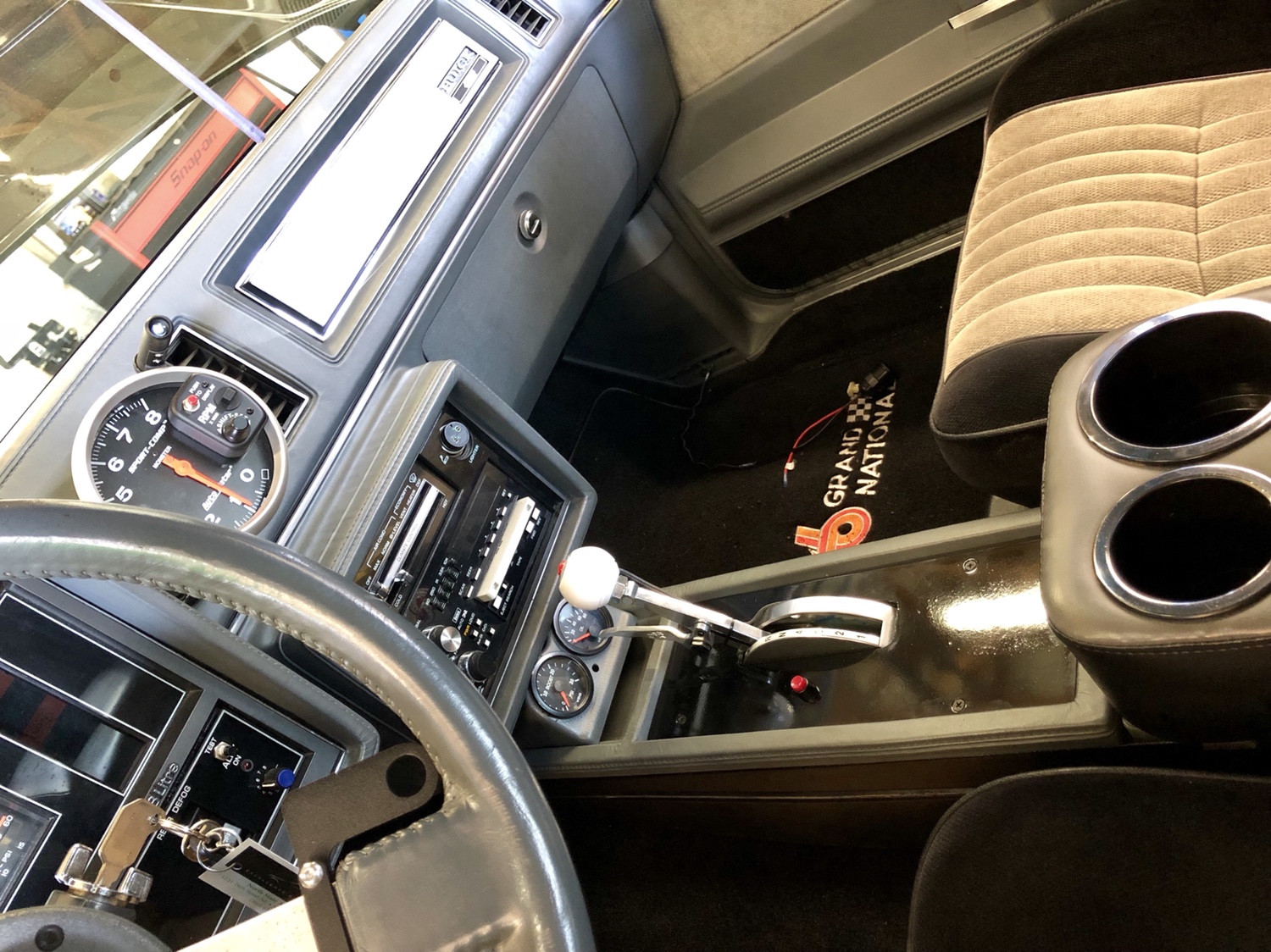

Got mine in finally!
What do you think. Trans brake button on handle and line lock button on the plate. Had to make a new face plate.
pacecarta
MAGNA
Staff member
Aug 1, 2003
9,068
747
113
RIP racewaypark, NJ
you need to reverse it , brake on panel line lock on ball
for one you need to shift with line lock applied to do a proper burnout , going to be hard to hold the button down and shift
and when on tbrake you dont want hand on shifter because launches can be violent and cause you to pull back the handle on the hit
i hold tbrake with thumb on panel and then just after launch reach up and shift

Is it a double tap from Park to Reverse?
yep a bit annoying and the handle doesnt move from where it starts so its difficult to know what gear you're in ..not my choice for a shifter , i had to put gear indicators on the dash bezel and a needle on the cowl to be ableto tell what gear it was in ..silly but it worked

That’s definitely unique. I know a lot of 80’s GM cars had a little gear shift indicator located in a window thingy which was located on the steering column, very close to where you have yours.
Your setup looks nice for using the stock console.
