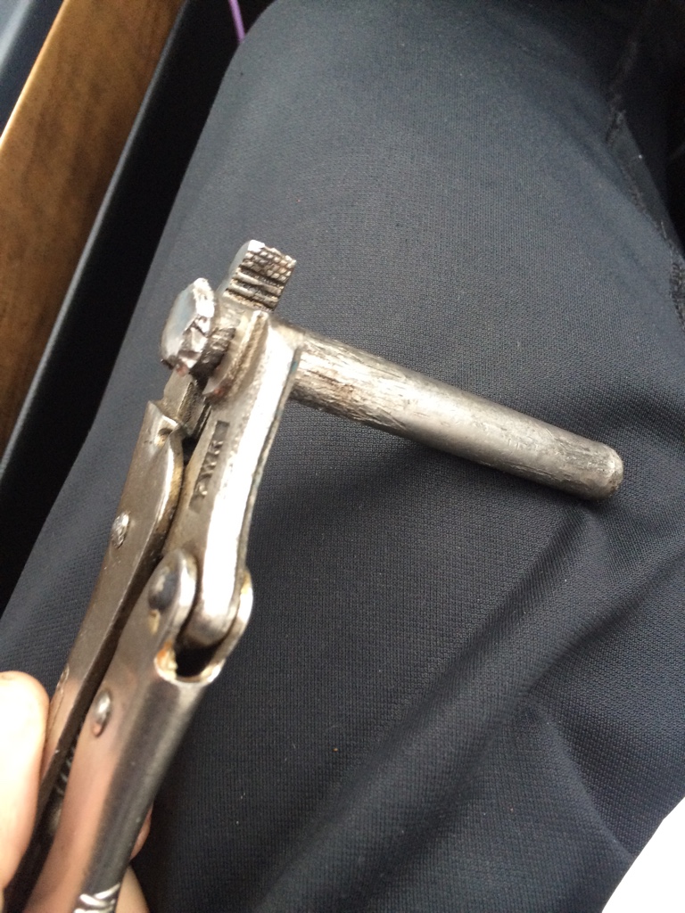

Using a solid punch like this with a sharp hammer strike to the head of the bolt will get it done. I remove thousands of rusty bolts a year with this. I break less than than half a % of bolts I attempt. Hitting the head of the bolt sideways in the counterclockwise direction or even clockwise will shock the fastener and break the oxidation layer. Spraying with oil doesn't usually work. The penetrant can't get down the threads far enough to do much good unless the entire part is soaked 100% submerged for several days. Heat will work if used as Jason described but care must be taken because the bolts will anneal near the surface and remain hard deeper in the thread and will be prone to breaking off when turning them out.
^^^^^^^ This. I tried everything - penetrating oil, melting a crayon, melting a candle, heating with propane torch. Broke the first one off. Did some reading and saw a previous thread about smacking it. Went to the garage and got the biggest Ford Wrench I had and took out some frustration. They all busted free no problem.
