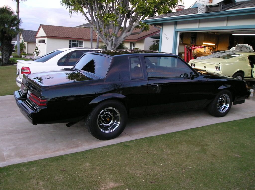

Welcome to the site. Pics of your car would be very cool. Many closet Mustang people here.;) How much static compression are you running on the Muskrat? Also, do you plan on running a Meth injection? What lifters are you planning on using on your buddy's cam swap?
Here's a picture of my 87 GN. Don't mind the 67 Fastback GTA in the background.;)

Mike, those are some sharp looking cars you have pictured. I'm a big fan of turbo v6's. To me an old pushrod v6 with a big turbo hanging on it is much more interesting than any of these v8's running around.
