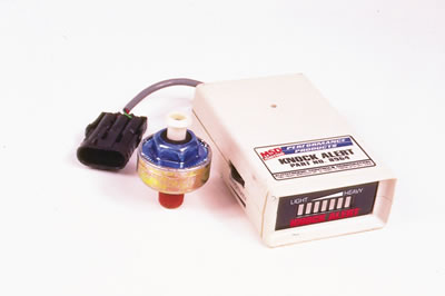

Hey guys I just wondering if anyone knows if you can incorporate a MSD Knock Sensor alert kit to operate w/ the ESC for the XFI? Do you have to use the FAST Knock sensor or will the stk GM sensor or supplied MSD knock sensor do??

If your using a jumper harness for your XFI just tap into the stock knock sensor wire with the MSD unit
Or hook the stock wire to the MSD sensor.
If you are using a stand alone harness you can still do it
But you must install a gm knock module first
I don't have a jumper harness..just the FAST harness w/ a unused esc wire already wired into the connector. So splicing the msd harness to the esc wire won't work and instead I need the knock module?
No that should work,But your F.A.S.T system isnt using the knock sensor without the module
