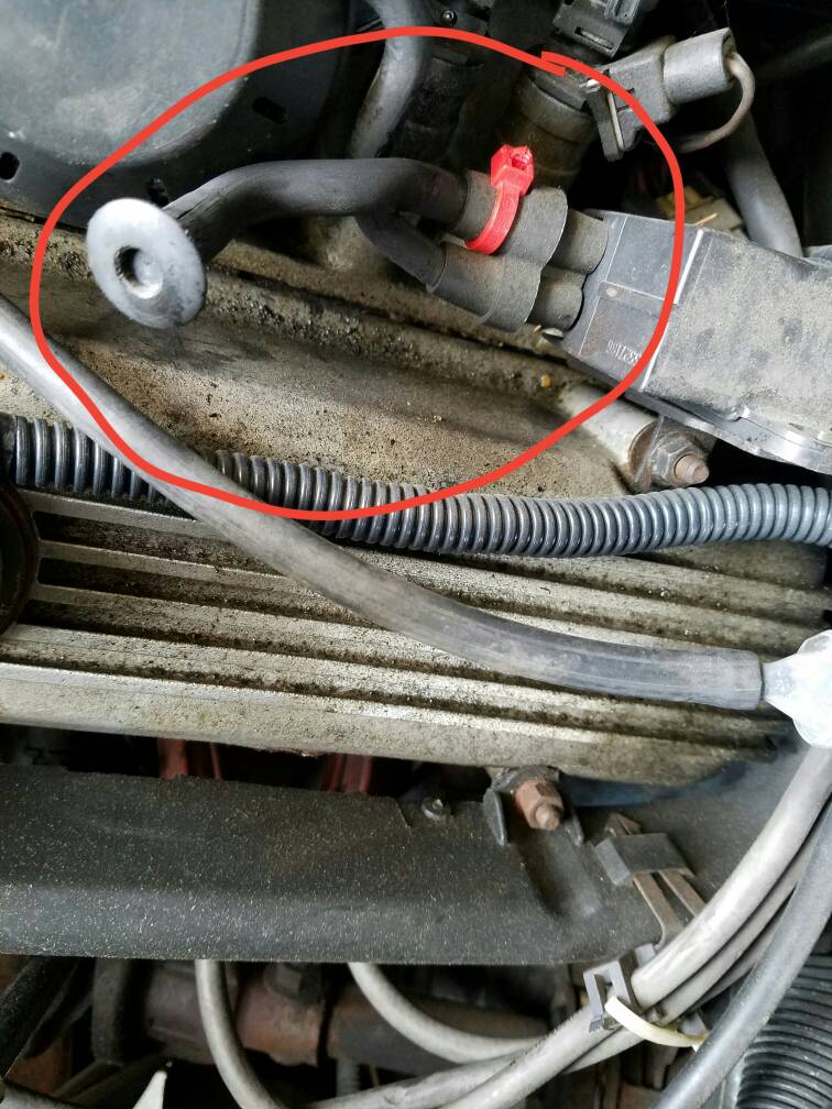

Ran a smoke test and seem to be getting traces of smoke conning out of here but all vac lines are tight and new.

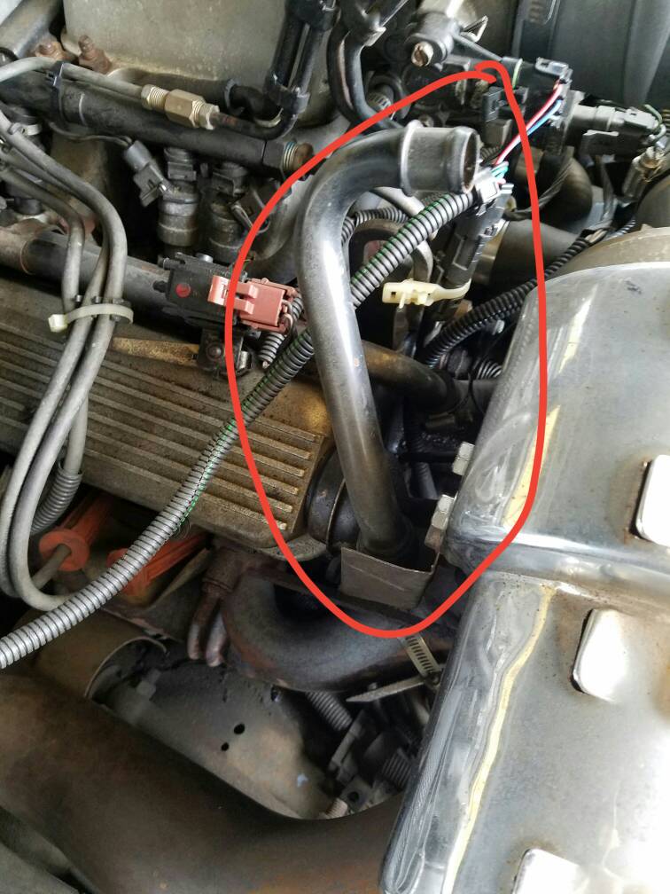

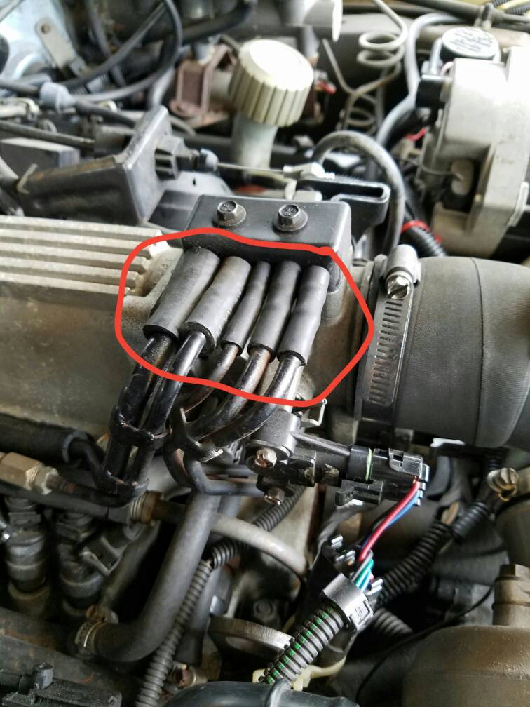

then noticed some of this stuff which I'm not really sure where it goes

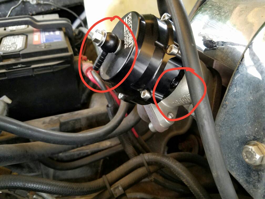

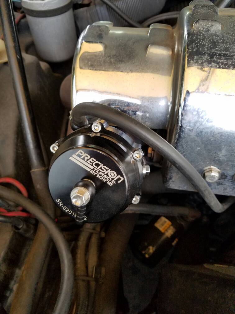

and also if these ports on the wastegate should be plugged
was getting a little bit of smoke on the lower port but it had no suction to it.

2nd photo is EGR control solenoid - if it's not being used you can remove it and get rid of the associated vacuum lines and/or bypass them. 3rd photo is from the factory line that runs a breather to the stock turbo inlet... most people remove the whole breather and add a small filter on the valve cover. Last photo of the wastegate... I'm really not sure how it's working if both ports are open... at least one should have a vacuum/boost reference. I would look up the instructions from PTE to see the proper vacuum routing. hth

Ok just plugged that bottom hole with a bolt I found in the wastegate box. This is how the gate is hooked up.

Ok so since plugging the hole on the gate boost is now where it should be 15/16 as apposed to 20+ like before. As for blm when the car is warm it is now at 139/140 as apposed to 150. With a slight increase in rpm it drops to 136.
