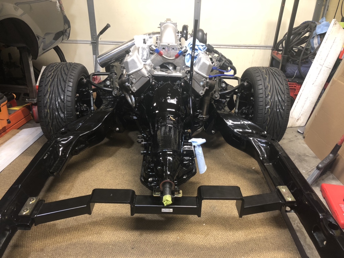

Here you go

Thank you. I’ve been looking for a good deal on a 400 but seems like 95% that I find already built are Chevy pattern.
87national55
Fits nicely on the 2004R... only concern but I think I be ok is that pan to crossmember clearance.
