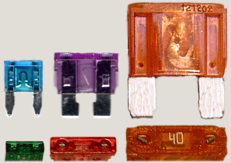

You can use a MAXI fuse. The Maxi blade fuse was developed in 1986. It's used to replace fusible links, fusible wire and meet automotive OE (Original Equipment) standards. But your going to need a fuse block that can hold them. They are bigger in size than Regular blade type fuses. Then just keep a spare in your car. This will be a lot easier than trying to change out fusible links by the side of the road.;) Make sure to keep your fuse block water tight or way from moisture.

get
MAXI FUSE​
MINI, REGULAR, and MAXI Blade type fuses
