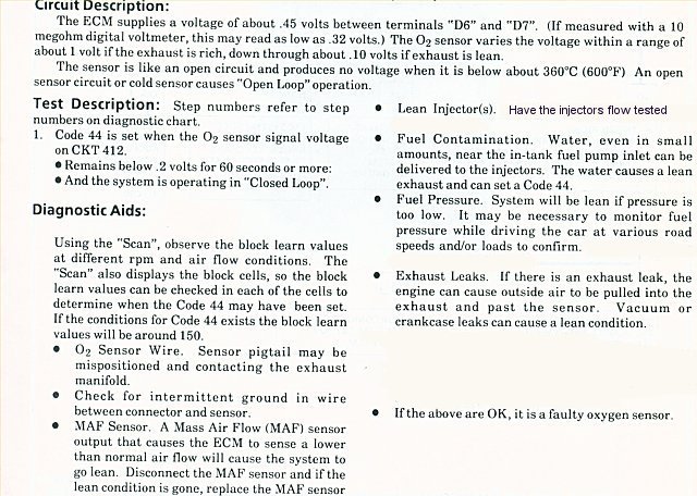

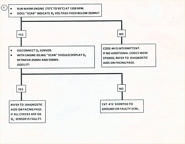

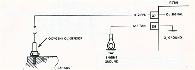

This is from the Buick repair manual
Code 44
Lean Exhaust
