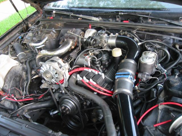

above is my engine bay. that is a Hydroboost setup.
if you have a late 85 you might have a powermaster iirc...
What the hell do i have?? i dont think its powermaster, those have the big ball n stuff right?? That and i just sold my OLD powermaster n it doesnt look the same at all to what i have in the car right now. SOMEONE has to know, im gonna ask my brother.
I believe i may have the wrong MC , if that were the case. what do i ask for at autozone, off what car would work?? thanks
