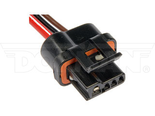

anyways from my understanding i go to autozone get a alternator for a 98 camaro for example, open the alternator and spin it 180 degrees to clear the up-pipe. what i dont understand is how to wire this into my stock wires

wiring a CS series alternator is criminally easy once you know which wire does what.. google it, or just stop in at your local alternator/starter rebuilder and have them help you- might even have an adapter plug in stock to make it a plug in deal. i paid $6 for a plug to put a newer (oval plug, out of a 97 Tahoe) CS alternator in my 86 Camaro just the other day at a rebuilder. it was the exact same plug that they sell at NAPA for like $35.
you may be looking for this-
I found the correct pigtail/plug at Autozone and it's has a part number of 85854 and it's description is "Voltage Regulator Module Socket GM". I think it was $6.97
