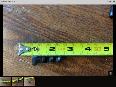

Does anyone have the specs for the bellhousing bolts?
Getting close to bolting the trans to the TA motor and want to get new bolts from AlloyBoltz but I need to give them the specs.
OK, I think I found the answer: 3/8 - 16 NC bolts. 2" long w/ hard washers and lock washers.
Sound correct?
No 1 3/8

Sweet thanks. That confirms it.
I ordered a set from AlloyBoltz and they were 1-3/8
Most of my engine bolts came from them. I believe they offered an ARP kit that I we t with. Worked great!
