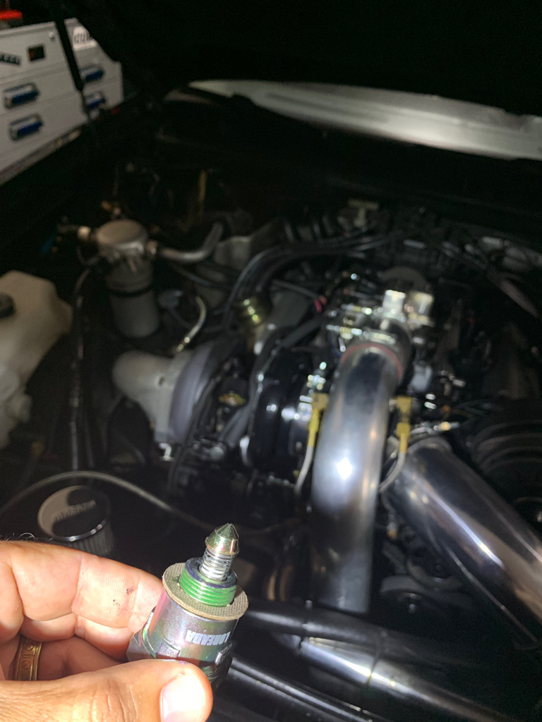

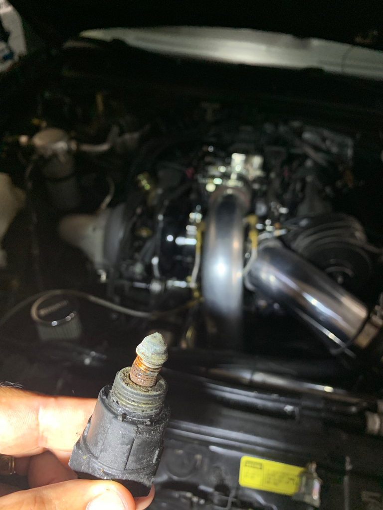

Update. I replaced the IAC and figured out exactly what happened. Issue is fixed. Here is what happened:
I had to go away for 3 months for some military training and out of habit, I drained the methanol in the alky tank and ran some water through the system so that water instead of alky would settle in the pump and not eat away at the seals for 3 months. I purged the water through the system and then let the car run at idle for 30 minutes. Well, I get back home from training and I get that IAC fault. Today I finally got the IAC in the mail and I see that the water had settled in the IAC sensors and corroded it away for 3 months. Lesson learned.
