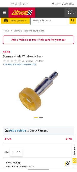

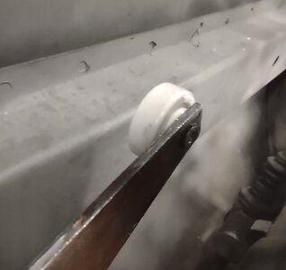

Pick up doorman 74407 at your local auto parts store and remove the roller from the pivot. That is how I repaired mine. It worked out perfectly and very cost effective. AND it actually rolls.

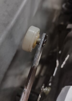

Here are the Gbody ones.... I couldn't make them work. Basically when installed they fit too close to the arm of the regulator

Thanks! Did you buy 6 or only 4? The 74407 looks a bit different, but there could’ve been a design change.
Thanks again.

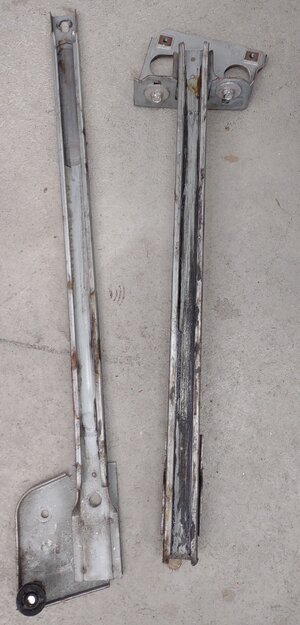

I only replaced one roller per side. Just the ones that were flat spotted. The one that slides virtually was in great shape. The main thing to do is clean the tracks and rollers really well. The original grease is thick and nasty. I used Kerosene and an old tooth brush to clean everything up. Then re greased the tracks, gear and pivot. Attached is a before photo... Couldnt find one after I cleaned everything up. I also debated on replacing the window motors, glad I left them. The windows move much quicker now. If yours are weak and noisy, now is the time to tackle that job. It's also easier to deal with the rollers with the regulator out.

I pried the wheel off and tossed the arbor or pivot. Hopefully that makes sense
