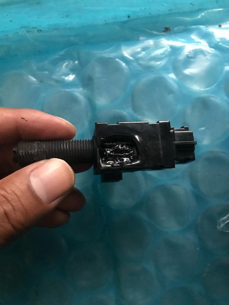

Okay how did you get this off I can unplug one side, the other side I can’t see to unplug, then if I do get it unplugged how do you unscrew it ? Thanks GregBeing that I just had brake switch problems.... I would check it first. Would also check the connector as well. Both were melted on my car.

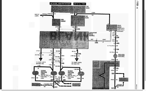

Get a meter or test lamp out and check the white wire on the brake switch with the brake light switch ON, you can either use the pedal, push to test, or pull the switch out to get at the wires easier and it should stay on as long as you have it out of its mounting.
If that white wire has power on it go up to the harmonica connector as mentioned a long time ago...
The test you have done with the Hazard switch proves the grounds and lights are good out back there is nothing wrong with the hazard switch and brake light wiring to the rear of the car.
