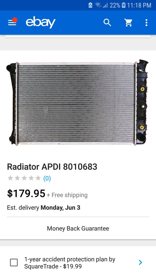

Hey Nick, I’m trying to find a direct drop in with fans and shroud. Some info I’m finding is that the cold case requires a little mod to fit correctly......does this differ between cars?? And what’s needed to make fit correctly?? Stopped by their stand at a car show and they look like quality pieces! Thanks
f body will be your cheapest route 80 bucks or so
I don't think it's really fair to leave out half the information.
Yes, the F-body radiator is a drop in. Yes, it's cheap. Yes, it works. However, it does not have the engine oil cooler and I believe the transmission oil cooler is in a different location and the lines need to be altered.
So I guess, technically, it's not really a drop in.

The F-body radiator is definitely the cheepest option and may be a good choice for someone who is thinking of running a separate engine oil cooler and separate trans cooler or doesn't mind adapting the trans cooler lines a bit.
Turbo6inKY found in road racing the engine oil was heating up the coolant and trans fluid when they were all tied together.
You can use the buick 307 v8 radiator.cost the same as a f body but no oil cooler.trans line fit with no mods needed.
