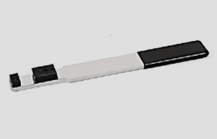

Do you still have the original torque converter in the car? I bought a simple flywheel wrench years ago to help with this matter.
Look up lisle or snap-on flywheel tool there are several variations.
