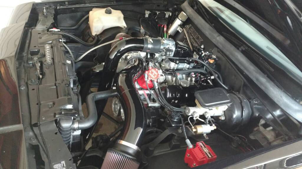

Years ago when I had my engine out and undergoing a freshen, I was frustrated with the complexity of a distributor, pipes, fuel lines, air inlet and all the other stuff going across the front of the engine, so I decided on a different path.
The main change was to turn the turbo 90 degree to the orientation to function best by having the air inlet facing the front of the car, and it eliminated the big air inlet pipe across the engine.
The picture says it all! :)
That's a great idea Nick. Sure does clean up all the mess in the front of the motor.
Gene, I am sure Mike has many hours over the years in refining the details, as my project has been on-going over 20 years!
I am also blessed to have many friends with various talent and ideas who have helped out with this project as well. :)
