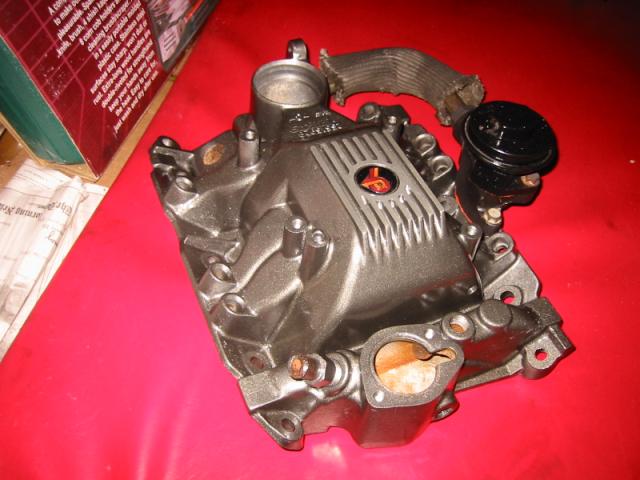

you have a problem here with making your own kit.... im not sure if you've ever had the turbo off but the deal is this.
how do you figure you are going to connect the charge pipes to the intake?
you are going to have to have someone make you a part. do you know anyone that can do that?
:D THATS A NICE INTAKE;) if your speaking of HOW TO get the IC pipes hook up to where the turbo inlet bell goes in. Then yeah i have thought about this, now you could have someone weld a same size pipe about 2-3'' higher so a slicone coupler could grab better. But if you ever wanted to go back to stock then no. If you had a spare inlet bell or one that fit the same. You could use that and use that n fab up something. maybe even just use a slicone reducer, whatever size the inlet bell is then get higher in size.
I have taken the turbo off myself and put it back, getting it off is easy. OK OK the 1st time i did it took few hrs, the 2nd time took me 15mins;) :D Getting the SOB on there is another thing.
I had to take off my hood and stand on my turbo so it could go in the damn intake. I know im sure there were other ways but i was the best way for me n popped right in with my 210lb body on it:rolleyes:

spearco kits had an adapter but it was kind of a POS. i have one that has been hacked up and it wont work how it was intended but it is possible, you just have to realise there is not much clearance under the turbo...
the crap part about it is because of the lack of clearance you have to route the charge pipes behind the intake, fuel rail, valvecover, then make a 90* turn and run them over the header and down to the front mount.... kind of a useless venture to cool the air and then have it run through a pipe thats inches above your driver side header..
