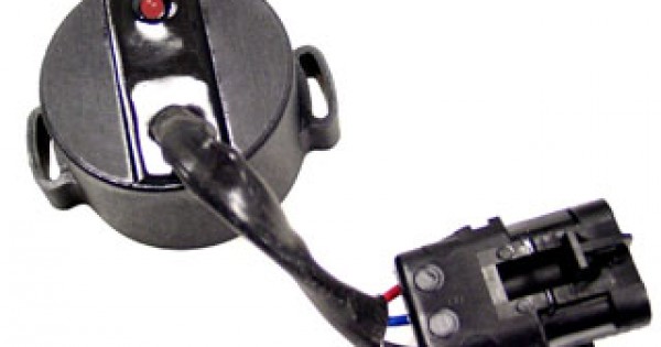

I have a general question about the camshaft sensor for the 86 and 87 GN's.
I was searching for a back up to have, simply as a spare and quickly realized that they are very hard to find.
There seems to be a very limited supply and I am wondering what usually fails on them.
I found a replacement camshaft sensor cap on GBODY's site, but am wondering if the main body also fails.
I have no idea why these parts are so difficulty to come by ?
Also what is their general failure mode ?
Is it the cap, or the main body that fails most often or both ?
Im sure there are reasons for them to be hard to come by considering the age of these cars
but since this part can shut down your engine Im guessing at anytime, seems kind of risky not
to have a spare one on hand.
Thanks Steve

The cap can get cooked and the resin can crack, and if water gets into the hall effect sensor, it can fail. Or you break the wires off so close to the housing that you can't solder a new lead on. Outside of that, they don't fail. They can't. A hall effect sensor is a magnet and a coil of wire. That doesn't go bad unless you cook it.
The mechanical part of the sensor is a mechanical part. It can wear out, but it takes a long time. LIke hundreds of thousands of miles. It turns at 1/2 crank speed and there's no substantial load on the assembly, so it'll last a good while. On top of that, as long as the window in the tooth trips the sensor anywhere from ~18-30 degrees ATDC, then the car's going to run fine, so there's a lot of tolerance for mechanical slop there before it needs to be replaced.
Hence the dearth of replacements. They don't go bad, so there's no market for a reman company to pick them up. If you find a particularly sloppy one, send it to GNS or somebody that rebuilds them.
If they ever start failing en-masse and a market for replacements is created, it's not terribly difficult to cut the head off a distributor and turn it into a new sensor if you have access to a lathe, and several people still make distributors for this engine architecture. So that's plan B.

Its much easier to find the new style cap (with the LED) than the old style cap. The new style cap doesn't work well with the after market ignition system (ie Bob Baileys). If you need the original cap, there are folks on here that will sell you a NOS, but they are not cheap. If you plan on staying with the original ignition, then just get the LED cap, it will last a while and is pretty handy to set (in the event you ever need to do so).
