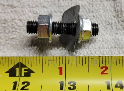

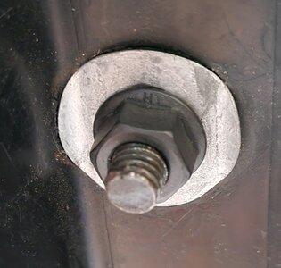

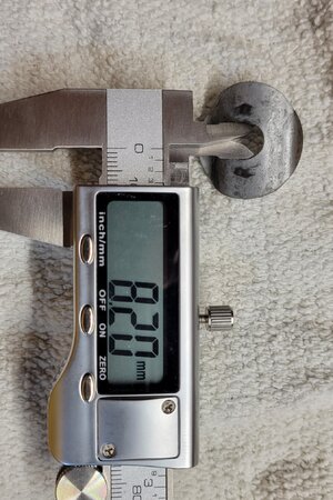

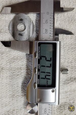

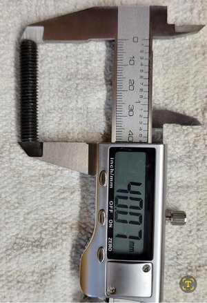

HotAirWH1 Well-Known Member TurboBuick.Com Supporter! Joined Apr 26, 2018 Jul 7, 2023 #2 Highway Stars Stud - Deflector (Air Dam) Mounting - Original GM Washer (1) - Deflector Mounting Spring Steel Washer - Original GM Make your own: Stud - 8mm x 1.25 x 40mm Nut - 8mm Spring Washer - 8.2mm ID x 27.14mm OD
