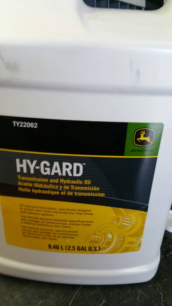

I run strictly hygard. It holds up to heat very well.
There's two viscosity hygard to choose from.
I will stick with what I usually use if it's too tight then I will figure something else out
What viscosity is this this is what I usually run
Ok it looks like the ty22062 has a viscosity of 30 weight. The ty6342 has the viscosity of 10 weight. Looks like I might try ty6342

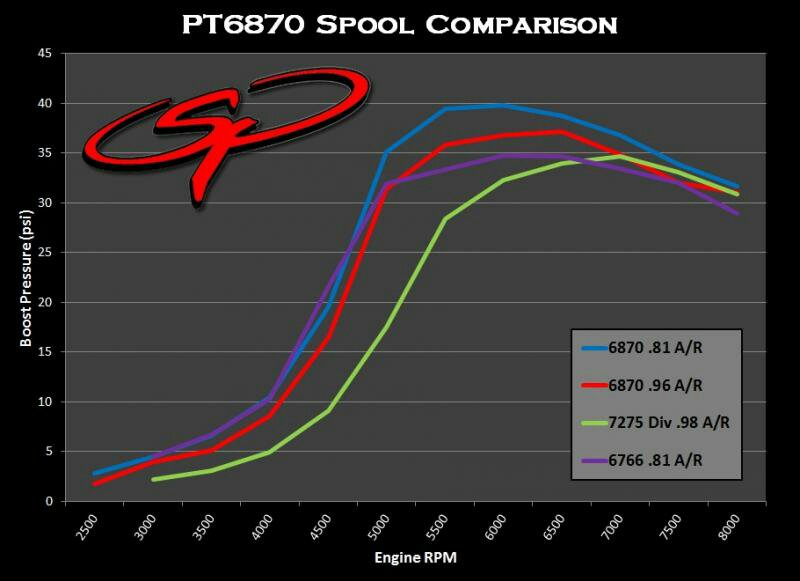

Wow that's a huge difference between the 6870 and the 6766 .81s starting at 30psi, didn't expect it to be that much.
Back pressure problems maybe?
Yes I was surprised to glad I'm going with the 96 housing
Lots of backpressure with the .85 three bolt housing. Lots. That's a big exhaust wheel for a three bolt housing.
Looking at the data I think I made the right decision going with the 96 housing

You can use fluid to tighten and loosen the converter a little. We use John Deer Hygard instead of trans fluid, this will tighten it up some. Switch back to trans fluid to loosen it up.
I wonder what the stall difference would be running the HY Gard ty 6342 have you ever run that it's like 10 weight
I run the lighter viscosity hygard, I couldn't give you a good number.

The hygard is going to lower the flash stall, i think you will need more flash stall. It will spool fine, just not be at the happy rpm range going down the track, leaving a little on the table. I pick up 2mph by having the engine at 6400 to 7000 rather than 6000 to 7000.
