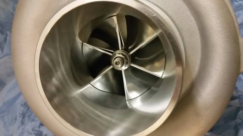

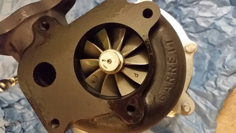

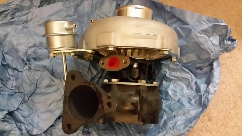

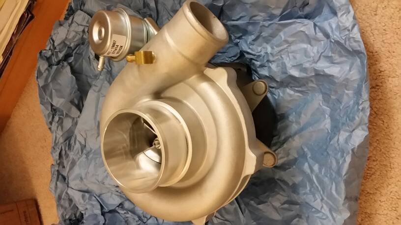

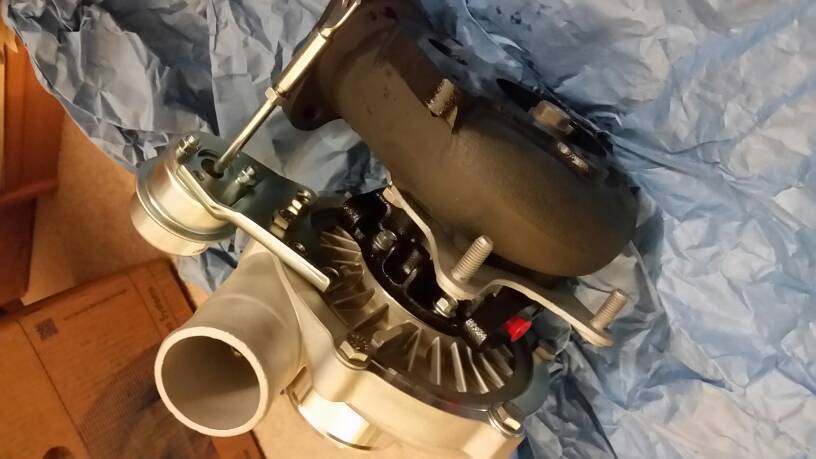

If you are looking for a stock-appearing turbo, I just finished putting a WORK billet version of a TA49 on a local customer's car. This thing SERIOUSLY impressed me. Right when you thought the power might fall off, as do turbos with stock housings/smaller size wheels, this turbo kept pulling harder and harder...I've honestly never felt anything like this..not in how hard it pulled, but how it felt like each time you thought it might drop off in power, it was as if it got a "second wind" of sorts, and pushed you back into your seat again and again..it was a trip how it felt!
If you are looking for 600-700hp at the crank, like most TR owners do, I'd recommend the WORK billet 6262. This is what SpeedRacerX, the guy in the first thread link I posted up above, purchased from us. He sent in his stock turbo and received a brand new unit, complete with; billet backplate, 360 degree severe duty thrust bearing, ceramic coating turbine housing, completely balanced and blueprinted turbo rotating assembly, billet 61.5mm compressor wheel, coated center section. Before you think these turbos look like your "regular" rebuilds, this is what his "rebuilt" turbo from WORK looks like:

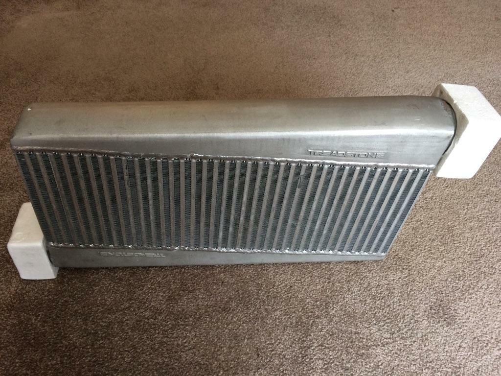

4) Intercooler= Are you looking for a stock location, or a front mount? Do you have a fabricator that can make you pipes and attach mounting brackets to the intercooler if the existing mounts do not line up on your car? If you are looking for a stock location unit, I would look at the For Sale section of this board. Currently I believe the only stock location intercooler (aka SLIC) on the market is the Precision unit, which costs almost $1,000. It is a great unit, but the price may be a bit much for some.
If you are looking for a front mount intercooler (aka FMIC) I would look at GN1 units if you are on a budget, otherwise RJC sells good units too. We (RPS) are currently in the process of designing and testing 4 new FMIC units for the Buick market. 2 of these use Treadstone intercooler cores, and the other 2 use Bell intercooler cores. For what its' worth, I am using a Bell core on my car after I became sponsored by them and their engineer designed, in my opinion, the best front mount intercooler that does not require modifications to the car, that I've seen. We still have yet to test the unit, which will be done later this year, but if it performs to just a fraction of what we've calculated it will do on paper, this thing will be unrivaled...BUT it is untested I just want to make that clear. If you were going to have a fabricator make your intercooler pipes, and add the mounting brackets to whatever fmic you get, I'd say to look at the Treadstone core if you're looking for a good budget IC. If you want some of the best IC's made on the market, I'd look at the Bell core.
If you're looking at a pure "plug n play" fmic that is better than the GN1 core, I'd take a look at RJC's 315 or 325 fmic's.
Treadstone core:
Bell core:
