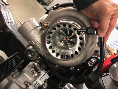

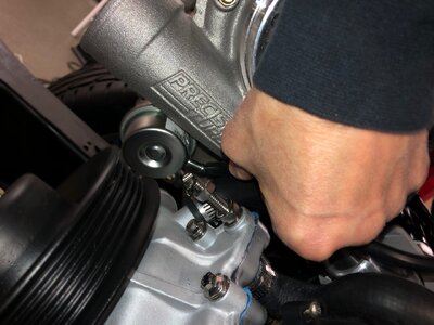

Picture isn't really readable to me, but maybe you can help me with my picture (and thanks much for trying!). Does the rubber hose coming off of the RJC boost controller fit on the end of the wastegate actuator in my pic? Then the other end to a vacuum source up on the intake? If so, goal is just to make it easily accessible to adjust? Thanks!

You can click on the picture to blow it up & check the picture at the top of the page.
The bottom should go on your compressor side & the other end(90) should go to your wastegate actuator.

Ok, I see I have the line backward--the vacuum line needs to go somewhere on the compressor side and the 90 end to where I was pointing with the vacuum line. Not sure where the spot is on the compressor, I'll have a chance to go look a little later.

Yours is a bit different than mine. On my TA60 the compressor has a vacuum fitting & the other end goes to the wastegate.
