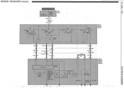

86 Buick grand national no power at connection underneath dash going to switch on steering column. Checked fuse all good. No power at wiper motor as well. Can’t find schematics anywhere has anyone been here or heard of thanks
this is for an 85 but quite sure it applies to the 86/87 - maybe someone can verify -
this should get you started
thank you my friend this should get me started appreciate it
Thank you this should do the trick appreciate it
assuming original wiring from the turn signal switch down the steering column, the white wire at the connector (under bottom of steering column) is notorious for breaking because of the bend in the wire at that connection. Check there first.
