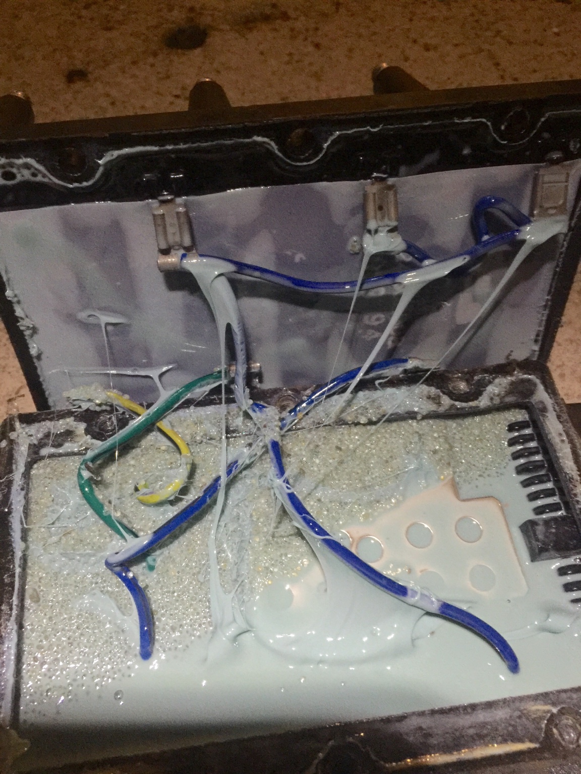

Have you checked your ignition control module? Pulled it off from the coil pack? (Disconnect battery before unscrewing and pulling the plug out) My ignition control module melted... You could notice melted glue stains on the ignition control module sides.
My GN would turn on with hesitation and run like crap. After riding it, I would turn it off. Come back to it and it would not come back on. I knew my fuel system was new and motor was new, except for that damn coil pack. So I got curious. Upon taking it apart from the ignition control module, I realized the real problem. Yikes.
I bought a replacement from Kirban Performance, and I bought the coil pack from them. Might as well do it all, right? Pretty cheap from them. Car turned on like a champ. Good luck!
Okay I replaced the ignition module and coil pack. Mine didn't look as bad as yours but still a little gooey and had a cracked in it so I just went ahead and replaced it....now the idle seems smoother but when I drop it in gear I can smell tons of gas and it feels like it's missing....I checked the wires inside coil pack and plug wires 3 times so I'm confident that's not it...I also noticed the led light on the cap went from flashing really fast to a solid light while running don't know why that is ...where would you guys go from here? I'm lost
