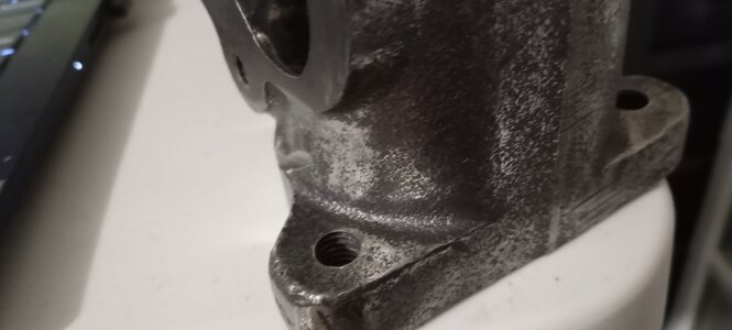

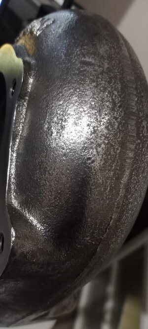

Should the exhaust housing be media blasted if the bare cast iron can't be achieved with a wire bush or a wire wheel with a drill? I attached a couple images and even using the wire wheel and drill I can't seem to get to the bare metal. When I first got the turbo I put some type of graphite coating on it, I got it from a guy who was doing his Cadillac headers with it. I am thinking that is the coating that adhered to the housing and I don't want to paint it and then have the paint not adhere because I didn't prepare it before painting.
Looks like a ceramic coat. I'd blast it with something.
I bought the turbo brand new from Bison and the exhaust housing was the base casting, no paint or ceramic coat. As I mentioned some dude on met online who worked at a location right next to I-75, which I took to work, offered me a little bit of the graphite to coat the exhaust housing and it appeared to work ok. I did have some rust spots to clean-up as I was preparing the housing for painting and I initially used a wire brush from Harbor Freight to try and remove the rust and then I switched over to a wire wheel and my drill. I am not sure what metal the wire wheel is made out of, but I think that it what is giving the housing the ceramic coated look. I also used my Dremel to try and clean the housing up to the bare metal look, to be as clean as the housing you started with, and I think that may have contributed to it looking like it has been ceramic coated. As a matter or fact I think using the Dremel with a sanding drum heated the graphite coating up and made it adhere even better and turned it into a shinier looking coat. Who knows, but I do have someone who will media or abrasive blast it for me. I purchased the same cleaner you recommend for cleaning before painting. In addition, I also bought the same Factory Gray Paint from Eastwood, however, I decided that I wanted to go with a satin silver color to match other components on my engine. Of course the color won't matter too much once you do your next run on the turbo shields.
