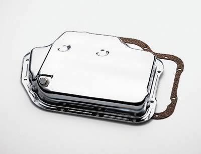

Does the current trans have what seems to be a long tailshaft approx. 9 inches? I may have enough hard parts from my fried TH-400 to service yours. Anyhoo...check here for oil pans:
http://www.monte-list.nu/tech/trannyid.shtml
For some reason the pictures on the link isn't loading...maybe try later or Summit on-line catalog does wonders:
TH-400: http://store.summitracing.com/largeimage.asp?part=MRG-9762
TH-350: http://store.summitracing.com/largeimage.asp?part=PRO-141-250
hth -stew

TH-200 4R oil pan: http://www.montecarloss.com/TCC_9.jpg
the pan under looks very similar to this one. so i'm guessing it is a th400 but the dip on the right side of the pan isnt there. the tail shaft is very short about maybe 5 inches. and it looks like they didnt drill new holes in the fraim rail, so the t2004rmay work because it came with a factory od trans.
