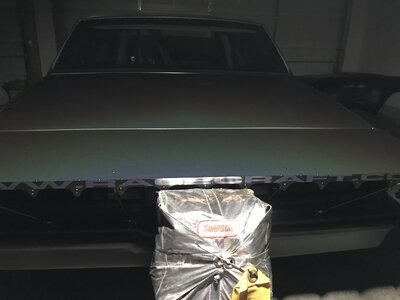

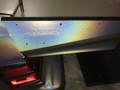

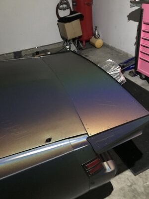

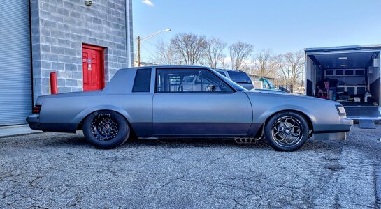

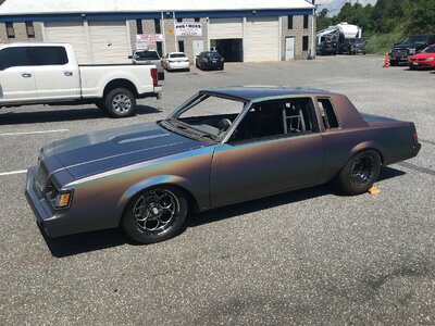

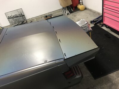

Friend of mine does everything his shop is full of lambos ,trucks ect here’s mine just had it done. Now it’s a race car that gets the shit beat out of it so to me it’s better than paint. I screw something up I rip it off and fix it. I also tried something and put my shop sticker under the wrap along with others that have helped me along the way usually cost around 3000-3500 depending on the wrap

Yes mine was primed but you have to prep it like it’s going to be painted. You can see sanding scratches through the wrap so make sure you get the primer flat with 600 grit and scotch Brite pads
that's a great idea of the stickers underneath ...showing the relief...
