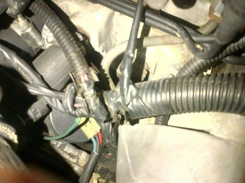

what is this
aufond
May 30, 2005
Wastegate solenoid. Should be hose to WG, unless a manual controller is being used. Or external gate.
THANKS!. stumbled on it during alky install.
using MBC.
Should i remove completly from car then?
Nah. Unless you really want & have some vacuum caps around to cap it off. And then there's the electric connector just hanging there looking like crap too.
Its supposed to be bolted to the valvecover.
Removing the boost control solenoid with a stock chip will cause the ECM to toss a code and set the SES/CEL light on. Which is why it is still plugged in.
