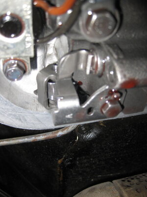

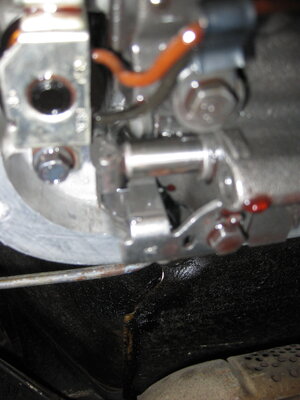

I started from the beginning and press the "D" button on the TV cable back to the firewall, and press the gas pedal to the floor, hearing the TV cable ratcheting forward.
My question showing in the photos, after press the pedal to the floor should the plunger be flush or should there be a little bit of shaft expose?

from the pictures it looks like the plunger is fully pressed into the valve body is it not?
That's what I'm asking, is this the correct setting for the plunger to be flush with the valve body?
