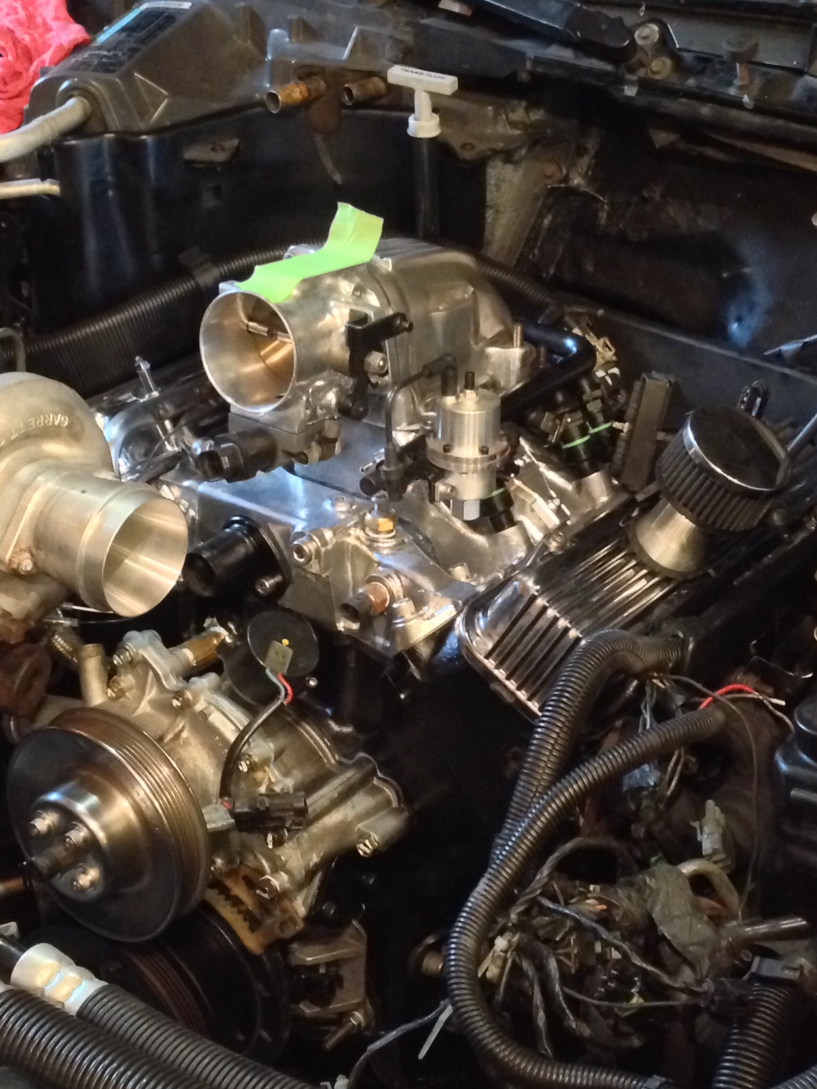

hello people; What would be the benefit of getting rid of the S hose? How about a pic. of your setup without.
IBBY
It's just to clean things up.
