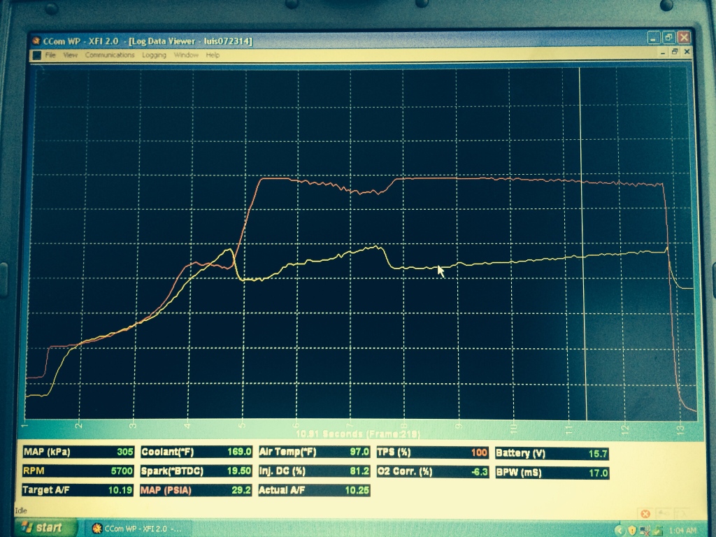

Here's the evidence:
This is with single PAC alky and 83lb/hr injectors up to about 143mph. Note duty cycle. It was 90* and humid here today. The turbo can't maintain manifold pressure as rpm increases. The turbos compressor cover is inadequate in this application most likely. Ex pressure is very high at the current mass flow. It takes about 5psi on the gate to make 1psi more manifold pressure!

Just so I'm reading this graph right (sorry...I'm still using Powerlogger), the top line is exhaust pressure and the bottom line is manifold (boost) pressure correct?

Lol. Your definitely taxing that comp side.
