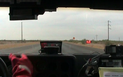

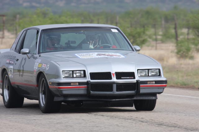

FYI, this is what +6 degrees of Caster looks like.
This is 168 mph with a 10mph crosswind with 255/50 front tires on a 2 lane asphalt road that is used mainly by oilfield service trucks, so it is trenched.
One hand on the wheel waiving at the radar guy:
Driver's view of radar board:
My hand is moving in the shot because I'm pointing at the board. 169 and I would have been DQ'd.
